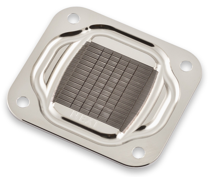

Base part with micro structure
The base part of the cuplex kryos NEXT is equipped with an extremely fine micro structure, the structural width is lower than 200 µm. The coolant is injected centrally through a slot-shaped nozzle and then runs to both sides of the structure. The base itself is manufactured from copper, nickel plated copper or .925 sterling silver depending on model.

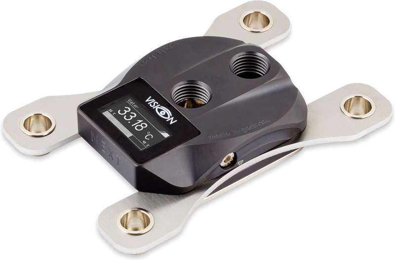

Retention system
The cuplex kryos NEXT retention system consists of 2.5 mm thick stainless steel plates equipped with nickel plated spring cups. Springs and knurled screws secure the water block on the motherboard, the retention system has a very clean look when installed. All retention system versions feature a mechanical stop for optimum clamping force and even force distribution. The knurled screws can be installed by hand, additionally a hexagon socket wrench can be used for easy installation.

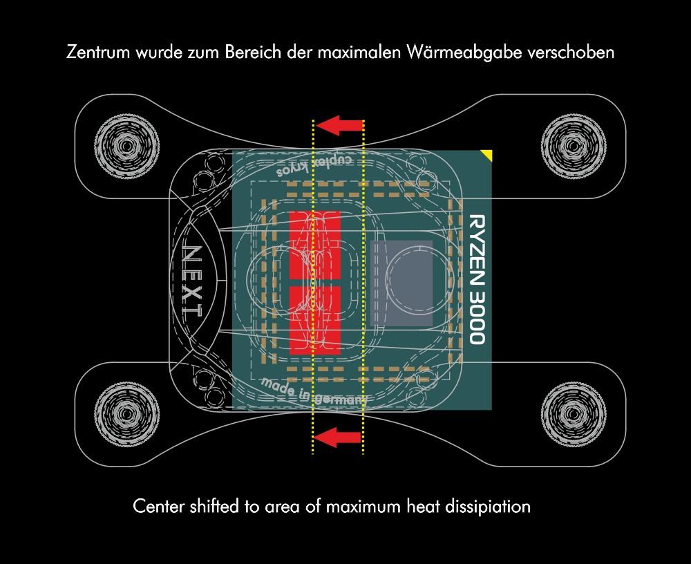

When using the AM5/AM4 9000/8000/7000/5000/3000 retention system, the water block is not centered on the CPU. Instead, the water block is installed slightly off-center for optimum heat dissipation in accordance with the asymmetrical internal design of these CPU series.

VARIO: Adjustable geometry
The geometry of the base part of cuplex kryos NEXT VARIO variants can be adjusted using four adjusting screws on the sides of the water block. Each CPU is unique - even slightest variations in height or shape of the metallic lids on top of current CPUs affect cooling performance of a water block considerably. Prior concepts to adjust the geometry of water blocks always required the water block to be disassembled and then reinstalled onto the motherboard, requiring significant time and effort. With the cuplex kryos NEXT VARIO, the geometry is perfectly adjusted in just a few moments. While monitoring core temperatures at maximum CPU load, simply change the geometry using the four adjusting screws. Temperature changes provide an immediate feedback, the perfect setting is quickly identified.

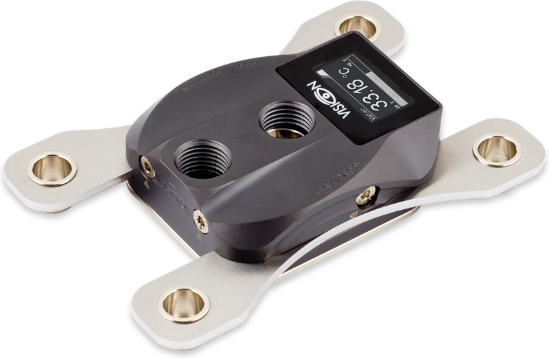

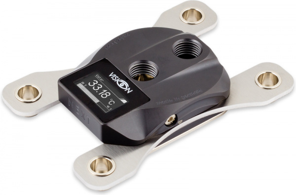

VISION: Integrated electronics
The VISION variants of the cuplex kryos NEXT are equipped with a microcontroller board and OLED display. The features include:
- Water temperature sensor integrated in water block
- Connector for flow sensor, can alternatively be used as alarm output
- USB interface
- aquabus interface for communication with an aquaero 5 or 6
- Customizable display output
- Various hardware data can be displayed from the aquasuite software, for example current CPU load
The acrylic glass variants of the cuplex kryos NEXT with VISION are additionally equipped with a RGB LED that can be controlled depending on temperature or via USB.
Due to limited space, a maximum of two cables can be threaded into the water block. The following combinations are possible:
- USB and aquabus
- USB and flow sensor or alarm output
- aquabus and flow sensor or alarm output

Technical details
Dimensions:
Socket AM5/AM4: 111 x 75 x 22 mm (not including screws)
Connection threads: G1/4
Distance between threads: 24 mm

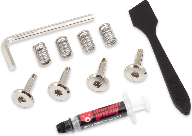

Scope of delivery
- Water block
- Mounting material (screws, springs, etc.)
- Premium thermal compound, approx. 0.5 grams in syringe
- Plastic spatula
- Instruction manual
